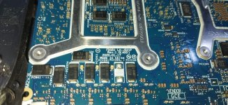

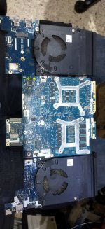

hello friends :)
i need dell alienware 17 r3 io ec rom
i read old rom with svod and upload it in attached
thanks for all
old ec.bin
ECROM 128KB
THANKS VERY MUCH FOR YOUR HELP
BUT THE SAME CONDITION AFTER EC ROM PROGRAMMED
THE BIOS UPGRADE INTERRUPTED BY USER DURING FLASHING BIOS
SO
LAPTOP WORKING BUT NO DISPLAY AND THE ERROR 7 BEEPS
I FLASHED 17 R3 LA-C912P REV 2.0 ALL OF 4 BIOS'S BUT NOT WORK
I ATTACHED OLD 4 BIOS
MY BOARD VER: 1.0
PLEASE CAN YOU HELP ME
17 R3 LA-C912P OLD.rar
SO
MY BOARD VER: 1.0
Not work how? you need provided many info...
REASON :USER FORCE SHUTDOWN LAPTOP WHEN UPDATING BIOS
WHEN PRESS POWER BUTTON
POWER LED LIGHTING
FANS SPINNING
CPU HEATING
GIVE 7 BEEPS
BUT NO DISPLAY
SO ONLY REFLASH BIOS WILL FIX THE PROBLEM
