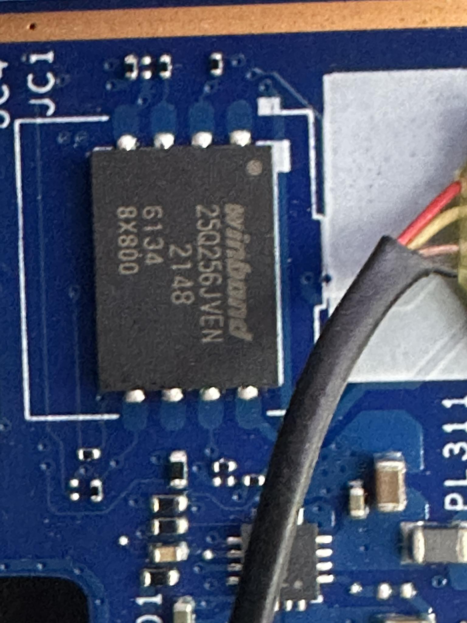

I have this board. No VCORE present. I've checked everything and replaced VRM IC but vcore still wont enable.
Laptop turns on, keyboard backlight is on but no picture (as there is no CPU power). GPU is turning on and gets warm but not CPU.
PVCORE_PG is missing from VRM IC.
I tried flashing this bios but same issue...
Here is my bios dump, can you help to clean ME and I will retest? Otherwise I think maybe the CPU is bad.
