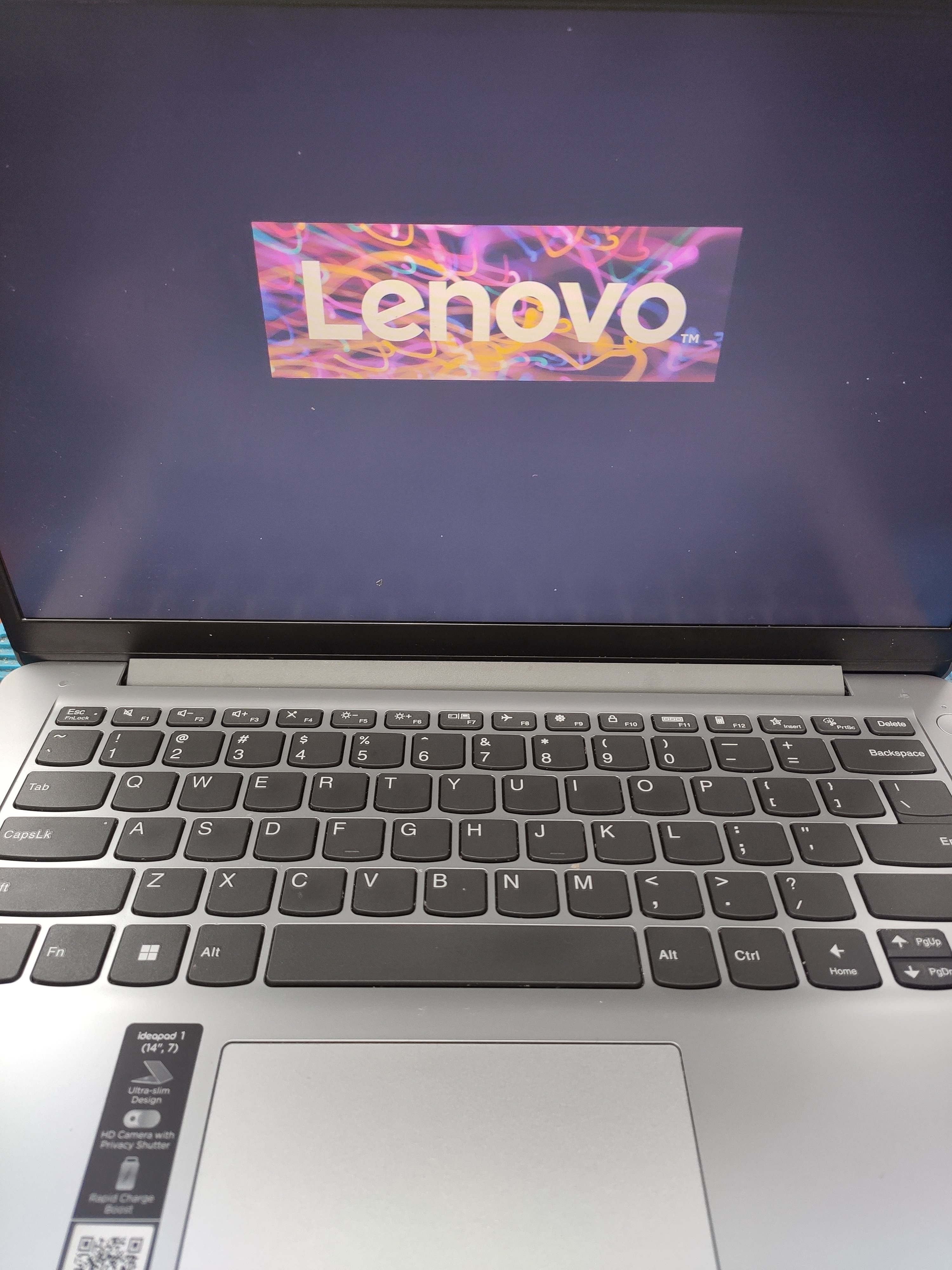

“Please, I would like you to make a backup of my BIOS, because this BIOS is turning on the keyboard LEDs, but none of the keys I tested are working.”
It was possible to resolve the issue. The problem was related to the BIOS. A BIOS extraction was performed from another compatible device, and after reprogramming, the equipment returned to normal operation.
