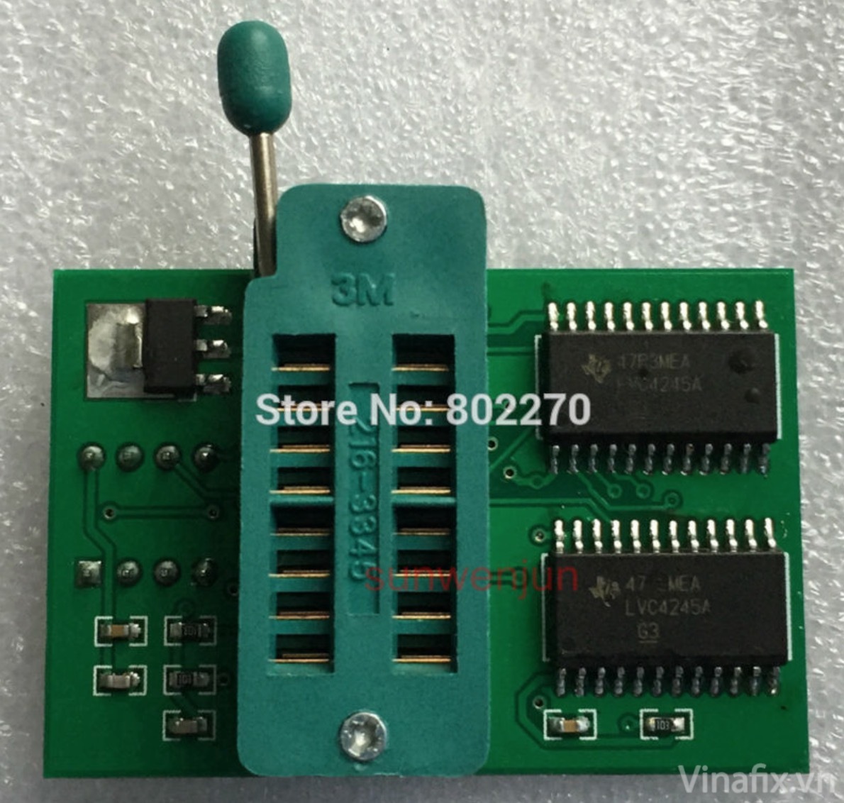

1.8V adapter for Iphone or motherboard 1.8V SPI Flash SOP8 DIP8 W25 MX25
ThienBui
Can use on programmers such as SkyPro TL866CS TL866A.
1.8V SPI Flash adapter for Iphone or motherboard 1.8V SPI Flash Memory SOP8 DIP8 W25 MX25...
This adapter can use on some universal programmers, such as TL866, Skypro, Stager and so on.
For example, TL866 programmable VCC is from 3.3V to 6.5V. If the chip is 1.8V, you need to use this adapter to program.
It can support 1.8V SPI Flash Memory chips of SOP8 (150mil or 200mil body width) DIP8 package, such as Winbond
W25Q64, MXIC MX25U1635, MX25U6435 and so on. These chips are often used on Iphone and computer motherboard.
Please note: this adapter cannot use on TNM2000 programmer!!
