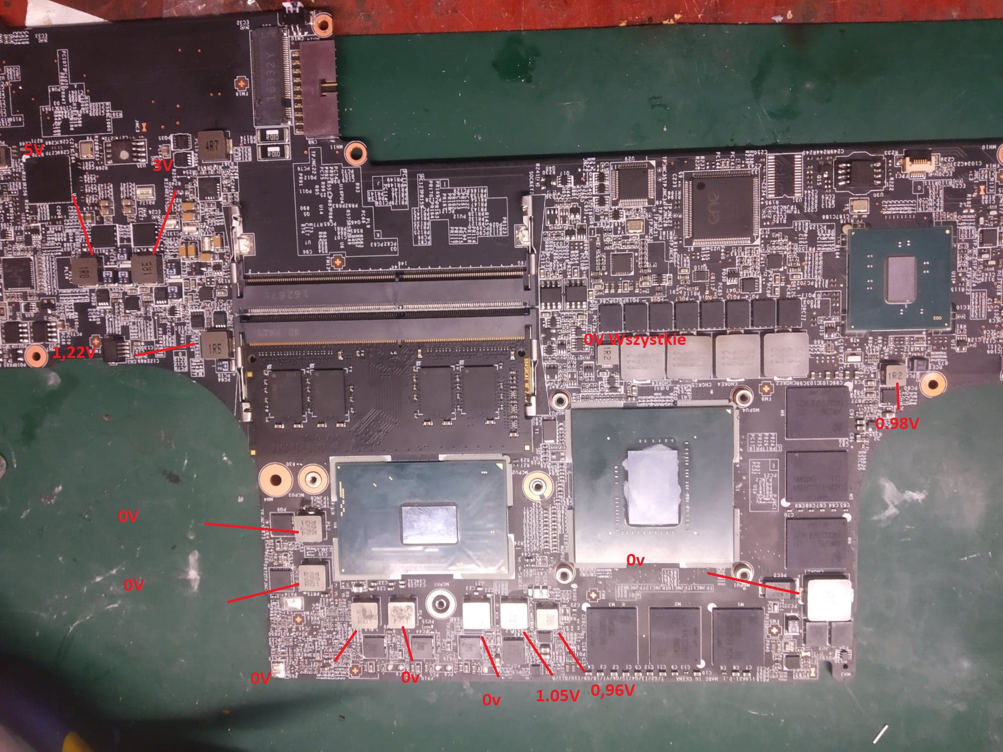

Hallo I have problem with MSI MSI GS63 motherboard isMSI-16k21 black screen. Very low
resistance on cpu 0.09 Ohm on GPU is 0,04 Ohm.
Power consumption motherboard is 0.242A,
Hello!
I have problem with my MSI. Fan on the GPU side do not work, they were replaced with new ones. What could be the reason?
Motherboard: MŚ 16K21
