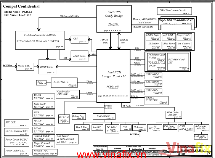

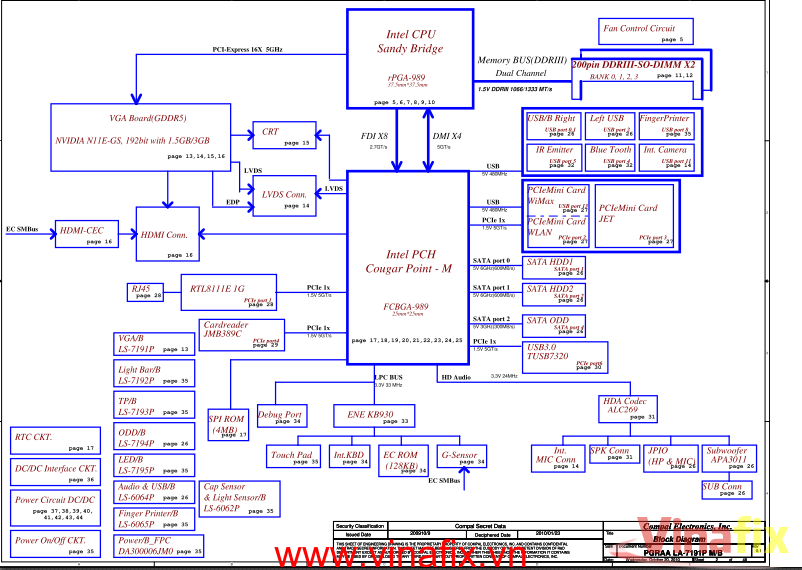

PGRAA_LA-7191P R0.1 1020 TOSHIBA QOSMIO X755.pdf
LA-7191p PRGAA rev1.0.pdf
Compal PRGAA LA-7191P Toshiba Qosmio X755
