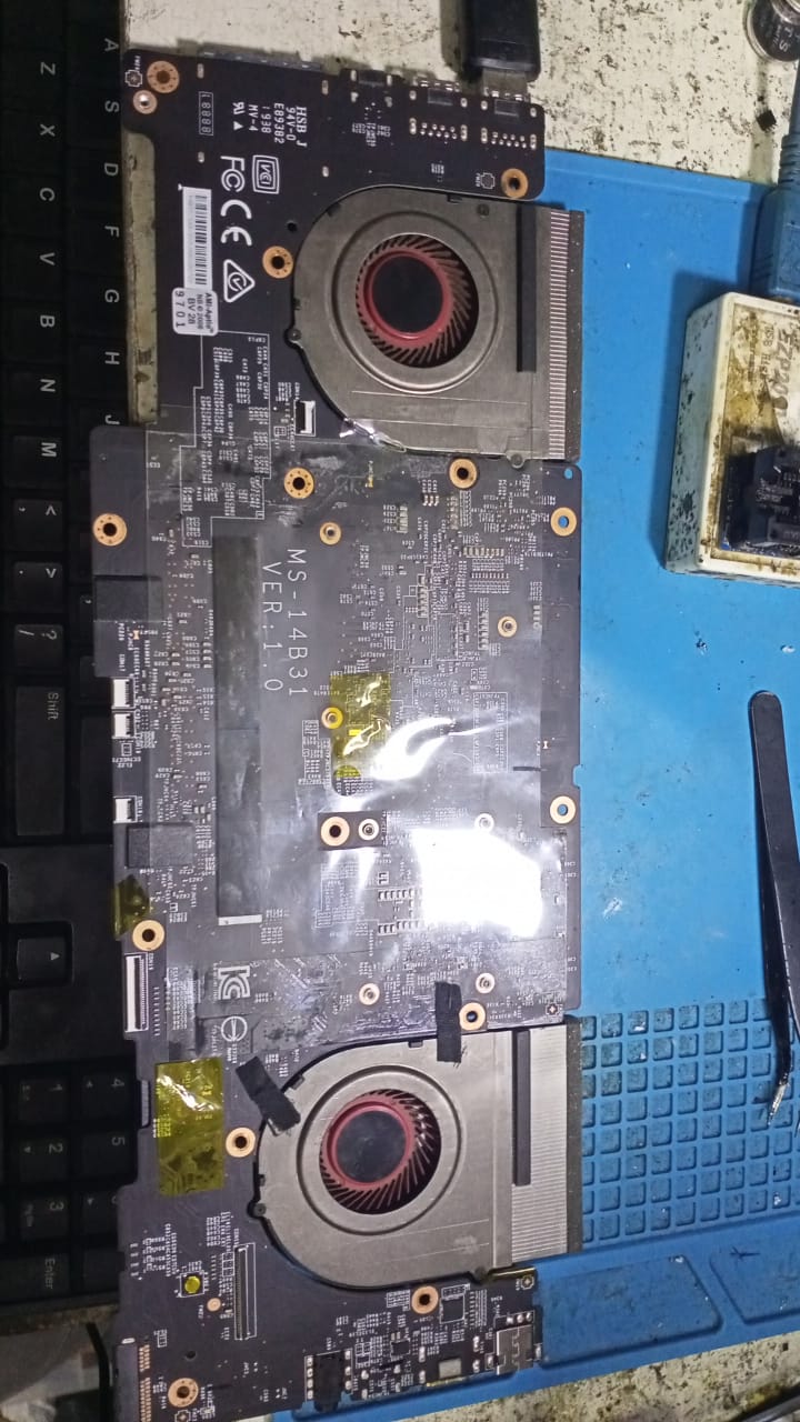

Help me build new bios MS- 14B31
have file old ?need u20 bios please
gone, i have empty bios u20 i need that, i found u20 bios on chinafix forum but i dont have access therehave file old ?
e nhờ a thiện clear lại giúp e bios với ạ.
MS-14B31.bin.zipIs there a dump for ENE?
fix lên chậm giúp e với a, cpu e i5 10210U ạ
thì clearme đấyfile a nạp lên nhanh , nhưng tắt máy nó lại tự khởi động lại, reset thì nó treo ở 0.60 , file cũ bình thường ạ
builds7321111.zipCan you rebuild it? No display.
Thanx
Doesn't work
There are many other problemsDoesn't work
When i try to open my and your bios with ME analyzer i read many messagesThere are many other problems
What does that mean?When i try to open my and your bios with ME analyzer i read many messages
Error: MFS Scratch Page 4294967295 Header CRC-8 is INVALID!
Error: Detected MFS Low Level File 20 which has not been parsed!
Error: Detected MFS Low Level File 22 which has not been parsed!
Error: Detected MFS Low Level File 23 which has not been parsed!
Error: Detected MFS Low Level File 25 which has not been parsed!
Error: Detected MFS Low Level File 28 which has not been parsed!
Error: Detected MFS Low Level File 29 which has not been parsed!
Error: Detected MFS Low Level File 30 which has not been parsed!
and continue until 688
