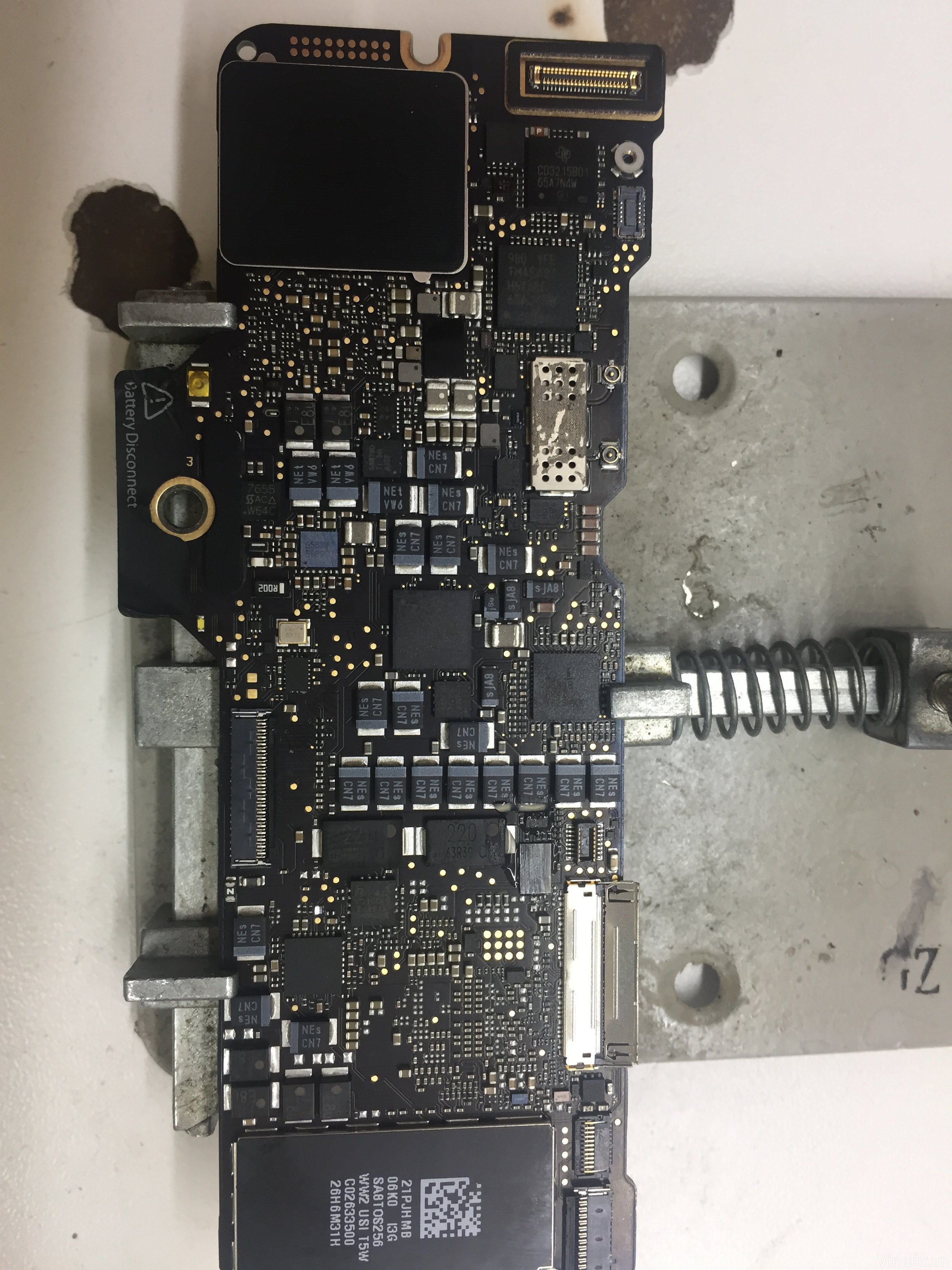

I try that with no luck. Setup not recognize SSD. I will try tonight several metods and post here my results.
No SSD is OK. I successfully install Ubuntu linux. Problem is in wrong BIOS dump, but I cannot find right one.

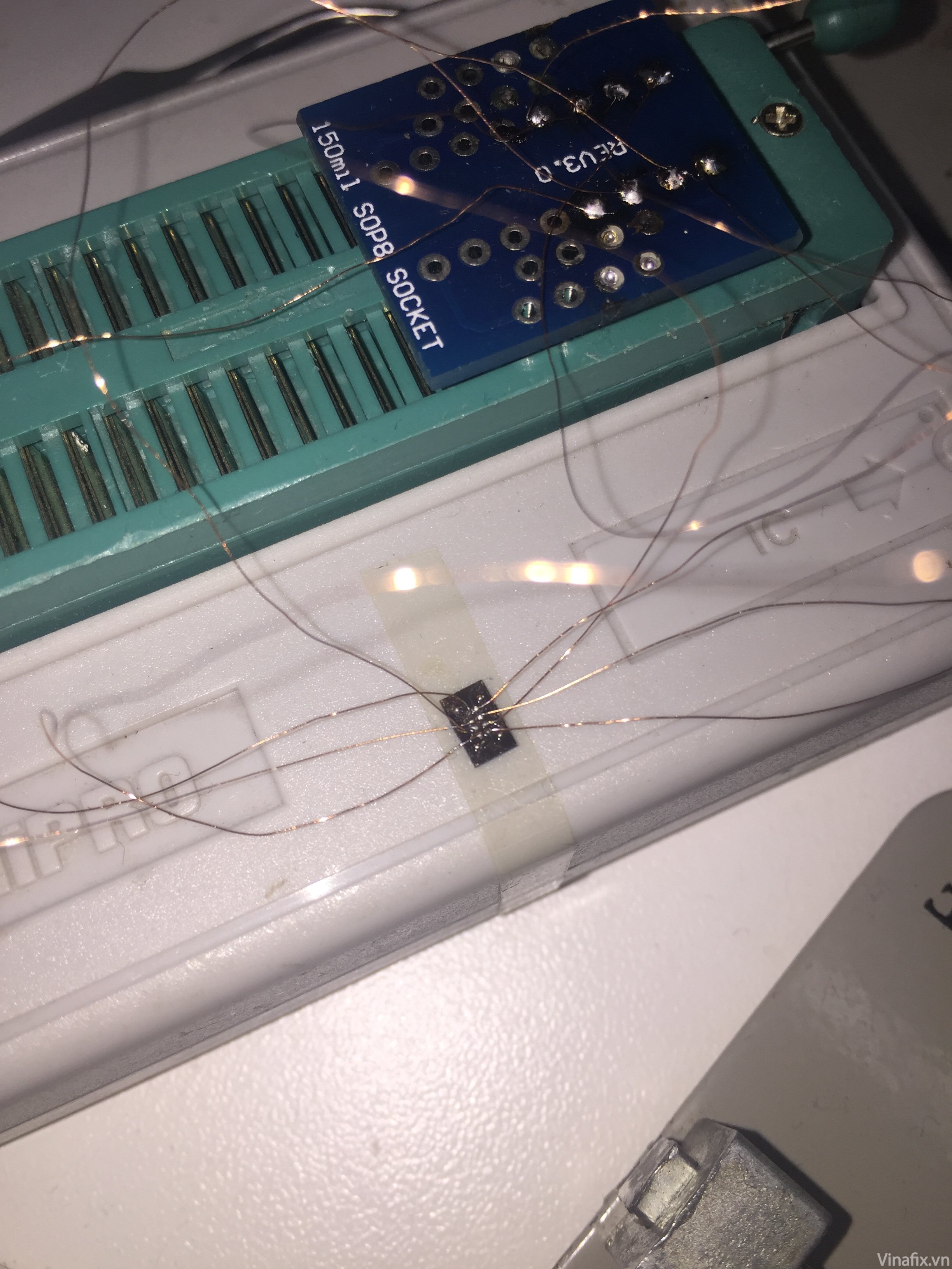

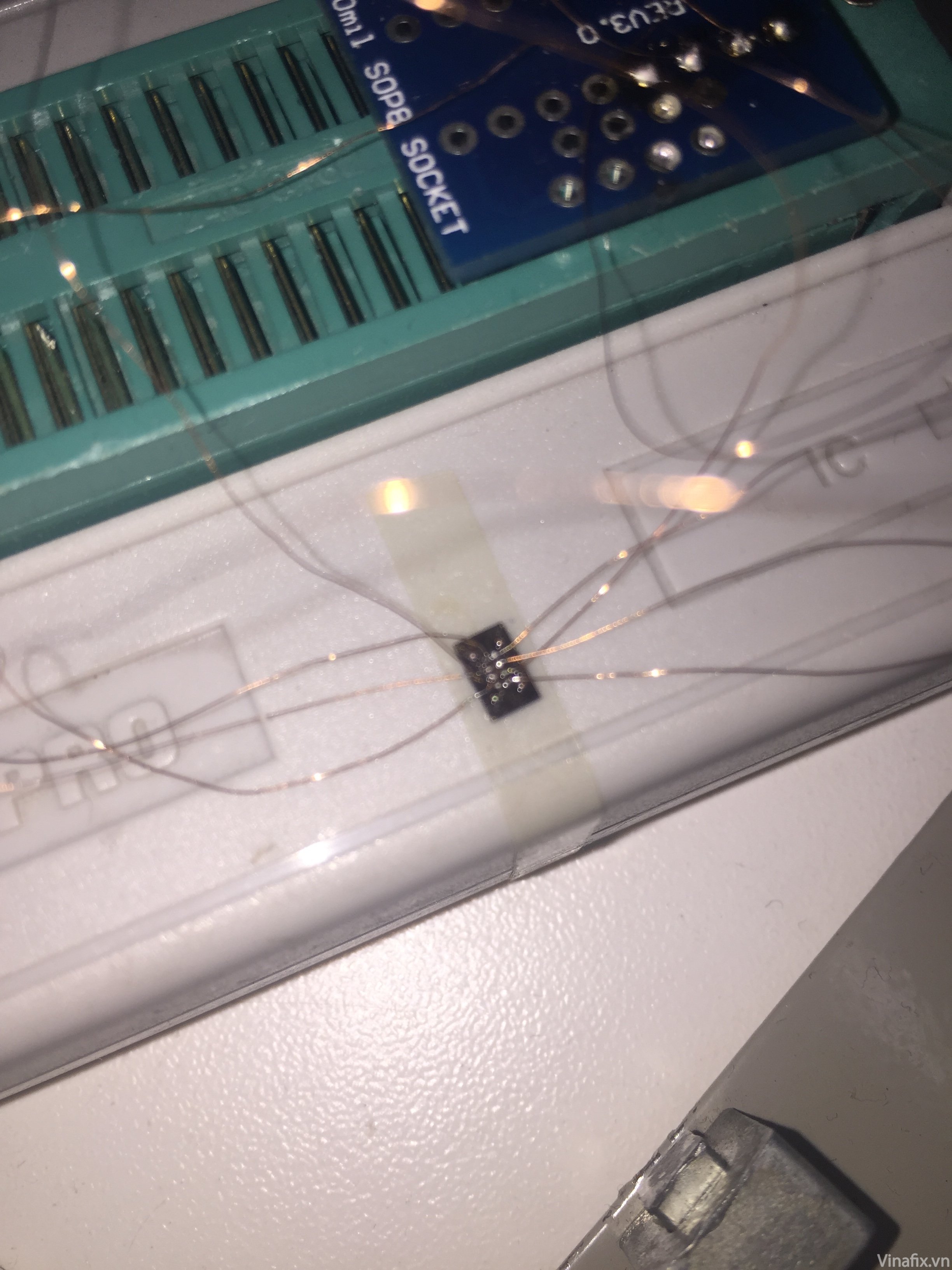

Hi,
The WLCSP (BGA) chip solder pads are not getting solder balls on them, I soldered thin insulated wire to the pads on the motherboard and now trying to attach a normal 200mil SPI BIOS chip to the wire, some advice on my terminations. I have tried but the machine doesn't turn on, though 3.3v is present at PP3V3_SUS.
Regards.
HI,i programming "in circuit" 820-00045 1534(2015),but 820-0024 1534(2016)not
I cant,i don't know what happen
I was only able to read the chip in ISP mode but writing to it in ISP mode was not sucessful. Waiting for another donor board to arrive so I can replace the damaged BGA bios.
