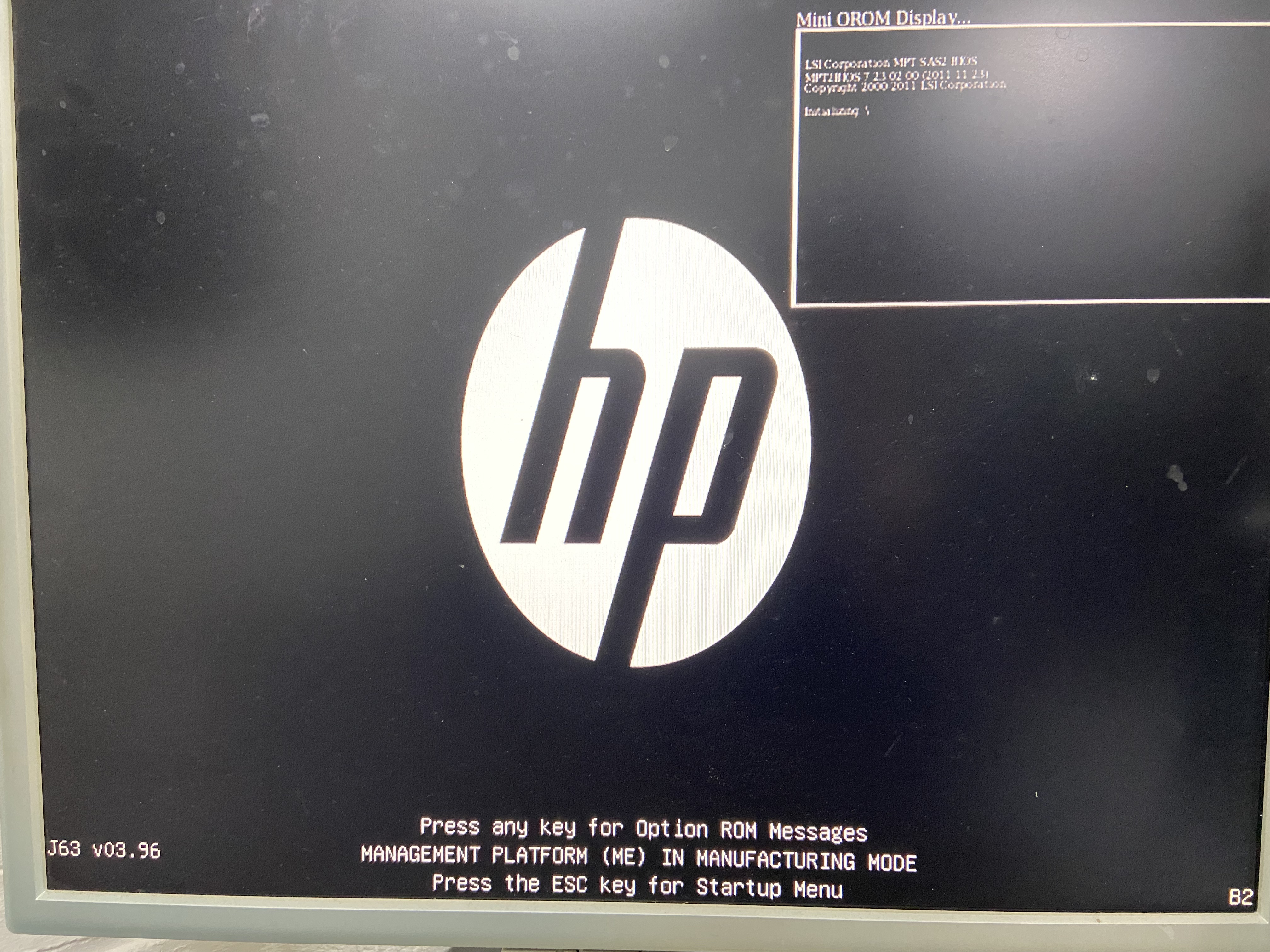

This error appears after you program the BIOS on top ?Bonjour,
Je flashe le BIOS avec ce fichier.
Mais maintenant, je commence par "Managment Platform (ME) en mode Fabrication". et je ne démarre pas sur le disque dur.
Comment désactiver le mode de fabrication ?
Merci !View attachment 198489
Yes, my BIOS was bad. Black screen.This error appears after you program the BIOS on top ?
Yes of course : HP Z820 Workstation_J63_0390.BIN.zipI asked if you have programmed the BIOS on top that I provided ?
you can save BIOS Original ?Yes of course : HP Z820 Workstation_J63_0390.BIN.zip
here is the file i had before overwriting ityou can save BIOS Original ?
send here I help check
I dismount the chip from the motherboat and I read/write it from eeprom chip readerflash is your job i don't know
how you can backup ?
