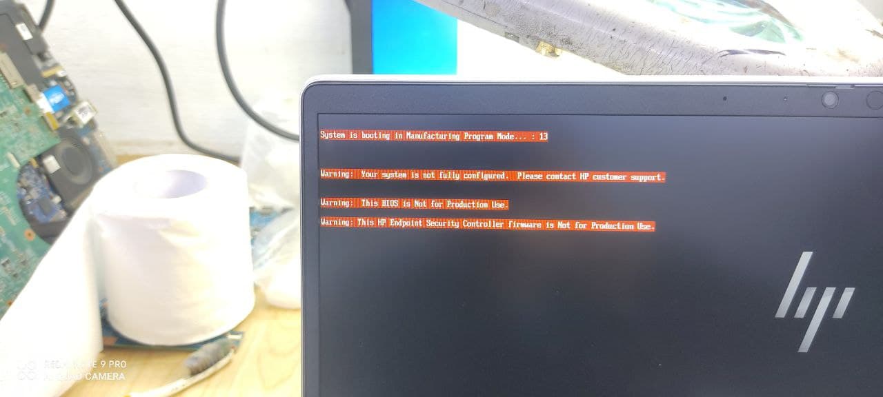

HP ProBook 450 G8 Notebook DAX8QMAMB8D0 - X8Q

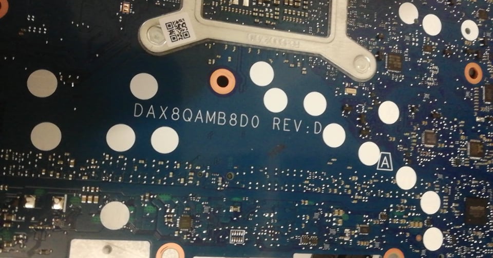

Above is : DAX8QMAMB8D0
I need: DAX8QAMB8D0
It's different or u add one more letter ?? QAM vs QMAM
* i use also googe ;) so that's why i asked
DAX8QAMB8D0 REV D -HP ProBook 450 G8 Notebook
1-25b256dyig---ECrom
1-mx25l256---SPIrom, BOTH 32M,
I DOWNLOADED THE
FILE T70_010401.bin IS THIS CORRECT? THANK YOU
