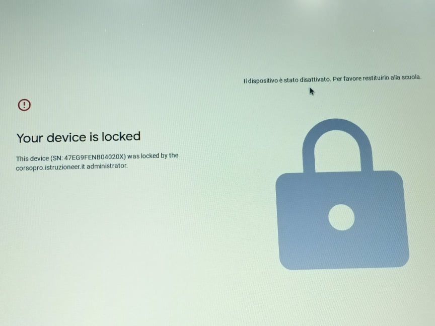

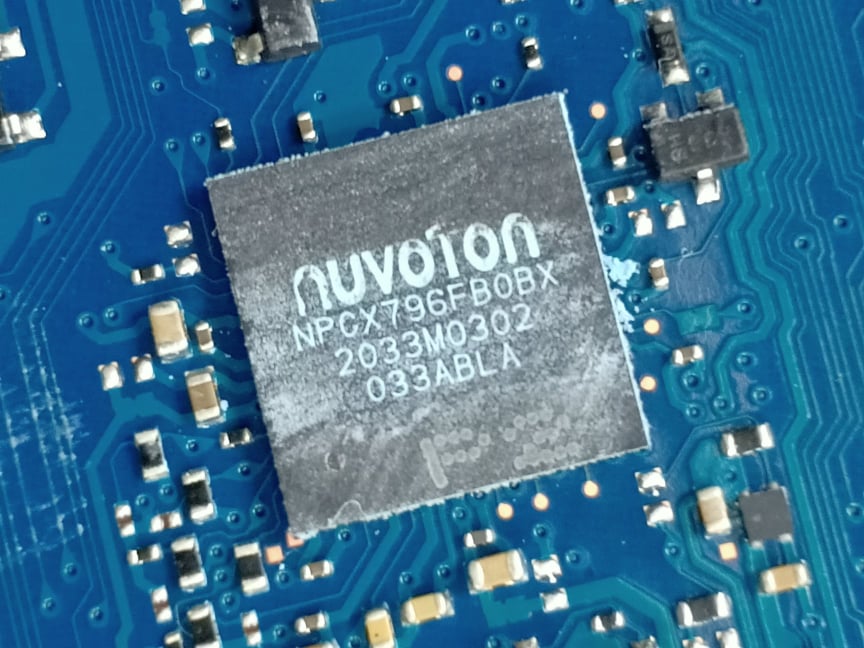

BIOS BA41-02748A XE350XBA chromebook
Hi
Can this i/o be programmed?
If it can be programmed, give me the exact program and schematic
Thank you.
where is this lock?
Please help me
only Programming BIOS unpasss
and
Flash this, try to switch to devmode (you probably cant but that doesnt matter). Let it restart normally after that. You should be able to log in now. After logging in, do powerwash. After powerwash, it should be unenrolled and with dev mode unlocked.
It is also possible to reinstall the OS
