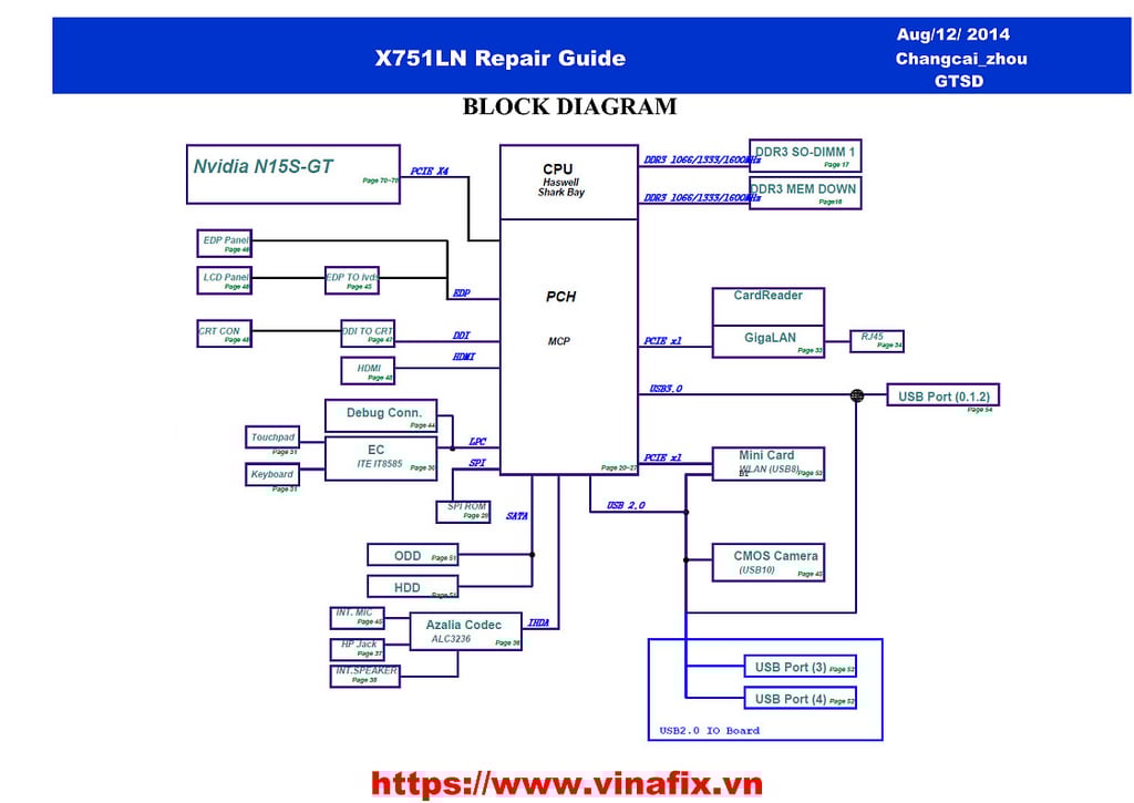

Asus Asus X751LN repair guide
Asus X751LN repair guide.pdf
