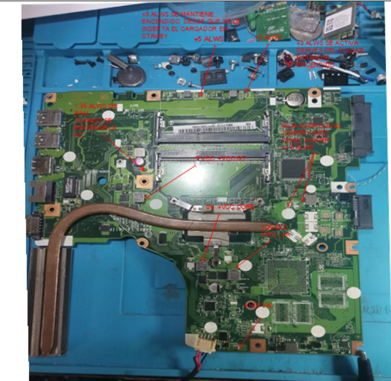

Ask ACER A4WAS LA-C611P ACER DOES NOT POWER ON CPU +0 VDC CT +0 VDC CORE AND 3 ALWS SOURCE ACTIVATES WHEN POWER BUTTON IS PRESSED
